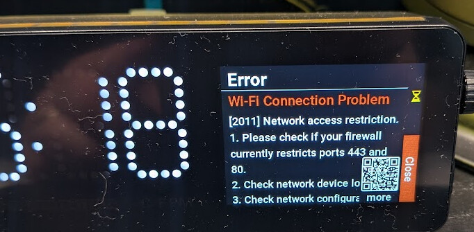

Below are a few screen shots of the errors.
Finally it comes back and says “Todoist Resource Retrieval Timed Out. Please ensure a stable network connection and retry.”
I have a very large Todoist. Is it possible that it’s timing out before it can fully load? Is it possible I could have it limit to just a certain tag to test a smaller data set?

According to your feedback, it is very likely that the situation you described is that the Todoist resource size is too large and the Mini Dock times out while loading. We will handle this situation in the next version.
Currently, the Mini Dock does not support displaying only the content of a certain label. If you currently need to use it, please reduce the resource size or wait for us to update the version (expected to release a new version within three weeks)
